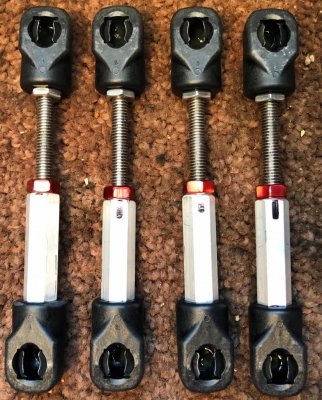

Next, we used the iPhone measure app to take an angle measurement on each CCD sensor. We then recorded what we had in order to replicate the factory angles with new adjustable arms from this source:
CCD Brackets: 507-381-4260

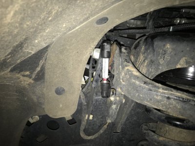

On the front, we found that the electronic solenoid on the shock was clocked differently once the spacers were attached. I believe we could have fixed this by swapping the left and right shocks, but by the time this occurred to us we had the front buttoned up and were not inclined to undo everything and start from scratch. We did have to fashion a tool from right angle bar stock to attach to the lower ball joint after it was removed from the lower control arm. With a block of wood to take up the gap, we used this as a secure way to leverage the lower control arm down so that the strut assembly could be installed. In the end, the CCD wiring had to be slightly re-routed due to the solenoids being 180 degrees out of their original location, but there appear to be no clearance issues. Still, if you plan on doing this, just plan on switching the left and right shocks out for each other once the spacers are installed.

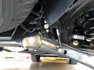

On the rear, we found that the two spacers each needed one of the lower mounting holes modified because the welds were too long and prevented the nuts from tightening flush to the flange. Easy fix, but be prepared for it. We chose to disconnect the CCD arms, then remove the inside lower control arm bolt as well as the lower shock bolt. This allowed the assembly to drop down enough for the shock / spring assembly to be removed easily. The top 3 nuts holding the shock to the frame mount were NOT as easy as the front ones were. In particular the inside two (especially passenger side due to the fuel lines) were a huge pain in the ass. The installation was straight forward, however, but since the CCD is not supposed to be lifted, no mention was made of the CCD solenoid. While re-installing the first one, we discovered the problem with the solenoid clocked 180 degrees out, so we swapped sides and sure enough everything went back together easily. We just tightened the bolts, settled the suspension, and torqued to spec.
Once the truck was back on the ground we installed the adjustable arms and adjusted them until each sensor was at the same angle as stock. Both front arms required approximately 3/4" of thread to be removed in order to achieve the desired angle, whereas the rear arms required nothing more than adjustment. I found that each complete revolution equaled roughly 1 degree, maybe that will help someone from having to take it on and off as many times as I did.

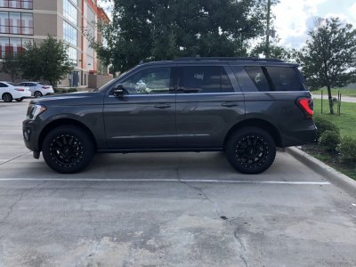

Looks great and nice write-up! I too was slightly disappointed in the overall lift height. In the end I think it looks good, but it's definitely not a 3/2

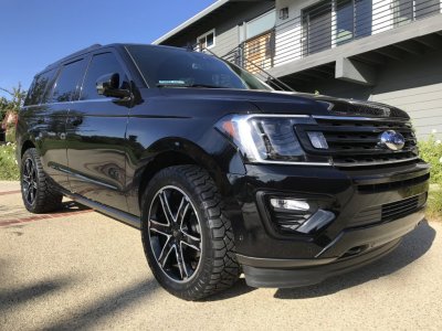

The 34s contacted the front inner fender liner. They were CLOSE to the deployable running boards at full lock, but there was still about 1/16" between 'em. Closer than I wanted though so we went with the 275 60R20 Terra Grappler G2s
