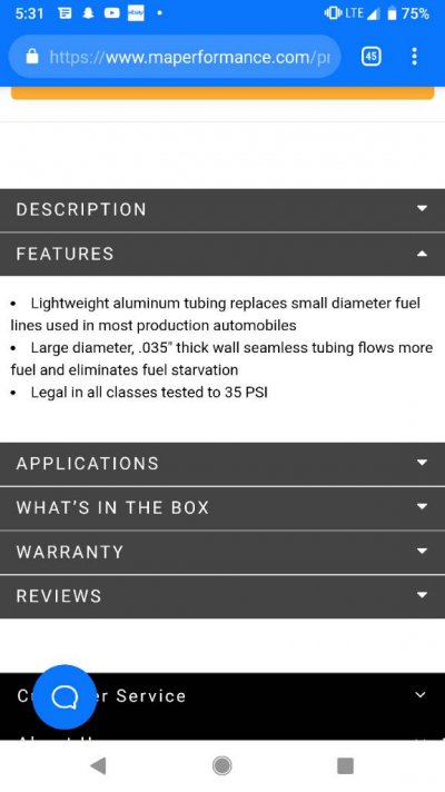

I hate to break your Bubble but that line is only rated for 35 lbs on the web site. Maybe you are going to do all that work for nothing. Why not check out a HVAC supply house!! Hate to see you go thru all that work and blow the line out. I think all tubing for ac is thick wall.
Where do you see that? They sell a smaller wall thickness one for cheaper but this wall thickness is pretty much spot on with stock and it's double the thickness of the cheaper stuff.
I think your looking at the .035 wall thickness tubing. This is .070 thickness. 264127364d16fdb4b3c7766c761068cc.jpg

I went by the part number you listed.Unless I made a mistake. I found this site that sells a lot of Kits and a/c parts. Nostalgic AC Parts Complete Universal R-134a Hose Kits
It looks like somebody has it listed wrong on their website. If it's not .070 I'll return it and look elsewhere. What website did you find? I'm new to all of this so all help is appreciated.

As long as it's aluminum and about the same thickness as the factory it will probably hold but those pressures do exceed 250 psi. That 35 psi rating is much much much below the burst strength and they're just saying that to be very cautious. Think about it. Even aluminum tubing that you could been with your pinky finger would still hold 80-100 PSI before it would rupture.
In all reality you could use some of the Rhino guard steel fuel line from the parts store or the Cunifer stuff if it were the same diameter and using compression fittings to fit. The inside is not going to rust this going to be coated in oil all the time anyways and the outside has that green coating which you can paint over and would more than likely Outlast the time you're going to own the vehicle. At a point like this it's all about getting the vehicle cool. If you can do repair in a couple of hours and get by 3 years plus then it's well worth doing even if you might have to do it again. You need that air conditioning.
You could even try to push a piece of rubber high pressure AC line of the appropriate size over your existing line and triple clamp it. I want to be slid on at least three inch minimum and then triple clamp with the clamps rotated in different clock positions around the line. I really don't trust these unless there is a barbed end. An ac or radiator shop could braze you a barbed end right onto the place where you cut it off at.
If the aluminum you get is fairly stiff and hard to bend it will probably be just fine.
If it splits open you'll just have to do it again.
