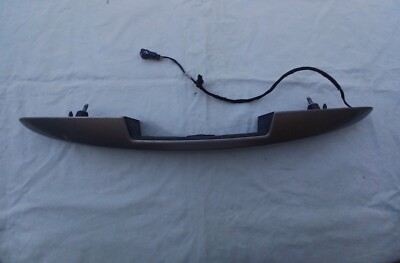

Hi, my button on the rear handle to open the lift the rear tailgate is only intermittently working (not power liftgate, the button just engages the actuator to release the door). Anyway, I looked around and surprisingly there really seems to be very little information about this online.
Ford wants to sell an unpainted handle with the button built in. Is the button serviceable/replaceable, or do you actually have to replace the handle (which is outrageously priced I may add)

According to the parts explosion, it does not appear the button is available independently. Part number for handle is
8L1Z-7843400-AAPTM. Available from online ford dealers like Tasca Parts for around $400 Tasca Online Price
On Ebay, stated to be New OEM for $231 https://www.ebay.com/p/1811134303
I would suggest you could find one - possibly in your original color, from a recycling yard.
Of course, if you are going to rely on the dealer to install, then you will have to pay their price for the part.

Here are switches that EBay "Says" will fit the Expedition. I have no clue, but for the price, I'd buy one and try it.

I did find the following on Amazon and bought it. The switch looks shallow enough and may fit in the handle, but I am not sure. I was hoping someone else did this and could confirm before I spent tomorrow morning trying to take this apart. We will see.

I am not a photo journalist (lol), so you all are just going to have to deal with my worded description. lol. This is probably very similar with the door closed, but I was able to keep screwing around with the old button to get it to pop the rear lift gate door one more time, so I did that. I would put something there so the door doesn't latch again while you work on it, because there will be several up and down movements of the tailgate.
The part that I linked from Amazon above did work and fit perfect (Ford part number = 1L2T-14K147-AA). Here is how I removed it.
1. To the right and left of where the rear glass latches, there are two body plastic rivets. Pop those out. Keep the glass open.
3. The plastic panels on the rear of the lift gate are two pieces. A "U" on the top (around the rear glass), and a solid plastic piece on the bottom. Pop the top "U" first. They just pop straight back (toward the front if the liftgate was closed).
4. Remove the inside plastic handle that you use to pull the tailgate down. This requires a Torx bit
5. The solid plastic piece on the bottom of the door just has about 10 body clips. Pop those straight back (toward the front if the liftgate was closed).
6. The solid plastic piece should just go up and out (to clear the glass actuator)
7. On the bottom of the inside tailgate, there are two circles each one having a silver nut on the inside (this is what secures the handle to the body). Remove these with a deep 7/16 socket
8. Unplug the button which comes through the left side of the tailgate to give you a little room to work. Remove the handle from the door to make it a little easier, but I did it while the wire was still attached to the body
9. On the back of the handle there are 4 7mm screws. Undo those. The handle backing will separate from the painted handle.
10. Just use a flat head screwdriver to push the clips inward toward the switch while pushing it out of the housing (look at the new one and it will make sense).
11. Unplug the wire from the switch
Install the new one following the reverse directions. Unfortunately I broke one of the body clips on the solid plastic piece in step 5 (the plastic stud that the metal clip attaches to). I really don't know how to avoid that with the design. I hope this helps someone else in the future.

I had a similar problem on my 07 XLT, basic pull handle lift gate not working. Me being a cheap bast*rd not wanting to spending OEM price on a new handle assembly because I knew it was electrical I removed the handle to inspect it for electronics and lone behold there is a microswitch the handle activates. Of course its not available directly, so i did some research and found one for another car brand. Had to modify it slightly but it worked out.
What I had to modify are the two little nipple tabs. They were on the wrong side so I got a fresh razor blade and sliced them off flush and super glued them to the correct side.
I did this August 2022 for $20 and has held up since, its now March 2025. Just make sure the plug matches.
