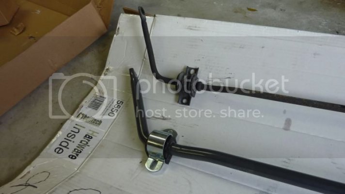

I wouldn't bother with poly bushings on the stock swaybar anyway. It's not going to do anything but add squeaks. But yes, I think the stock one is something like 1/2" or 15mm in diameter. If you want to do something for the roll control replace the stock one with a BelTec 5550 1" heavy duty swaybar. Same one they put on police vehicles. It comes with new bushings, and it'll actually improve the roll control of your Expy.
-Mike
Beltech 5550 at Summit Racing
Here's the Beltech swaybar next to the stock Expy swaybar....

No, the front is already 34mm bar. The rear is the weak link on the Expy. The aftermarket swaybar is a 26mm bar vs. the stock 13mm bar. The rear-end is what pitches around on the Expy.
