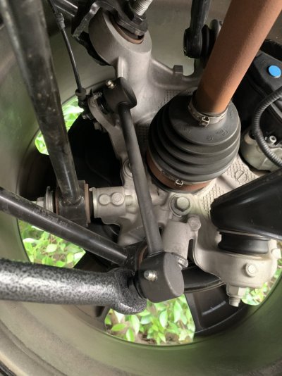

I have an Expedition Limited Stealth, 2019. I upgraded the front sway bar to the Hellwig with it's end links, which made a significant difference in eliminating the bobble sway. I later added a Hellwig rear sway bar, which improved ride a little more, but the front really made the difference. The stock sway bar is hollow and much lighter. A worthy investment if you would like improved cornering handling in this large SUV.
Hellwig makes end links for the Expedition? Do you have the part number?

Based on the photos these are the Moog end links. They look identical.
K750074 Front
K750052 Rear
Thanks, I have the Moog rear end links. I wasn’t aware of a direct fit aftermarket end link for the front, especially not from Hellwig, which is why I was asking.

@image98 what end links are you using front and rear. Part numbers please. They look beefier and I like having zerks. Thanks
Someone else beat me to it, but confirming, Fronts are MOG-K750052 and Rear MOG-K750074. Much beefier than the stock bar links with serviceable zerk fittings.
