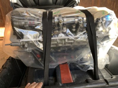

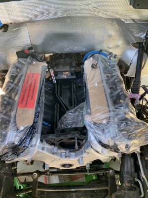

So we have decided that we will most likely be repowering our 09', which in the Boating world is the term one would use for replacing the engine. That being said I am going to try a few things first for diagnostics and knowledge since we have enough vehicles to cover if this goes down on us in a major way and we are forced into the replacement rather than when we elect to.
I had previously installed piece of crap coil packs a few months ago to fix the P0303 code and the noticeable misfire that became prevalent after that code flashed going up a large grade and experiencing a momentary loss of power. The thing ran bitchen for about 200 miles and then the misfire returned but was slightly less noticeable. After posting on here and other forums I now see the error in my ways when I failed to use OEM coil packs. Since I have elected to put a new engine in when the time comes I know that I will be wanting to have some things be new on it so I am going to start those purchases now so that;
  1. I will have them when the time comes and I wont have to shell out all at once
  2. To see if it fixes anything and may increase the amount of time we get out of it prior to the replacement.
  3. The loud racket I associate with the Cam Phase Position Sensors (CPPS) seems to happen after letting off of the gas pedal while accelerating up a slight grade while in reverse and eventually going forward up the slight incline that is my driveway +/-5%. This had become a very reoccurring thing. My thought on this was that (like makuloco) said "even though you will not get the codes popping up with the cheap coil packs it will cause other issues". While letting off the throttle I would feel a drop in the engine RPMs and then the noise & rattles would start.
  4. I gain some more life knowledge.
Yesterday I replaced all coil packs with motorcrafts. The vehicle had been siting for a week with a dead battery because I had left the key on after replacing the wiper reservoir, so the computer was clear. It ran really rough for a few minutes and then leveled out. It no longer surges while backing up and runs and idles very smooth(For now). I am going to replace all fuel injectors next. Spark plugs were done not to long ago. I will most likely get all new hoses, pullies, water pump, alternator and headers at the time of replacing the engine.
TLDR; Replaced cheap coil packs with motorcraft, seems to have helped with cam phasing issue, fuel injectors next.

I don't agree with your diagnosis at all. A bad cam position sensor, the engine won't start/run. There is no noise associated with it going bad. When fuel injectors go bad you get a code/cel. They can stick open and bleed off fuel pressure. It causes hard cold starts. The rattle you hear backing up, could be a loose heat shield on the exhaust. The front left ones are a problem. The misfire is a misfire, not slightly less misfire. Did you scan for a code or swap coil packs around? Brian Fordtechmakuloco, cautioned about knock off Motorcraft coil packs. So, Motorcraft isn't always Motorcraft, unless dealer purchased. I personally can say, I had good luck with a Accell coil pack. It was all Autozone had that day. It's been in there 8-9years along with my OEM coils.
The rattle is definitely in the engine and not a heat shield rattling. Im not sure how else to verbalize a "slight misfire" without being even more incorrect. From what I have heard there are many signs of faulty positioning but I may be wrong. I scanned the codes and replaced the coil packs that i replaced the original coil packs with and they are verified motorcrafts.
