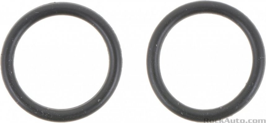

There's actually two holding it on back there. A real pain. Usually a 1/4" drive ratchet and socket works. Once they're removed you just pull rearward and the pipe will come off the front nipple. There's two small O-rings on the nipple that need to be replaced before the pipe is re-installed. If you have a mechanics mirror and flashlight you can use it to see those fasteners back there. The harness gets in the way too.
Ford Parts Giant Online Ford 2L3Z-18663-BA
Pair of O-rings for Pipe Nipple at Advance Auto ( 0.50" ID x 0.637" OD )

Ok thank you so much. Yes I have the mirror and ty for the heads up on o-rings. I'll be sure to remember to get them too.
