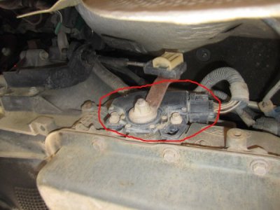

I was told the SNS is a multi-function switch that controls the back-up lights when the transmission selector is put into the Reverse position.
If you crawl under the vehicle behind the driver-side front tire, here is what you see:
attachment.php
Where is the reverse sensor?

Well I can't explain what happened...but my backup lights now work fine. It is possible the make-shift pigtail I made for the backup light socket didn't make connection when I checked using the mulitmeter. Regardless, looks like the switch on the transmission solved the problem. On to the next problem...
