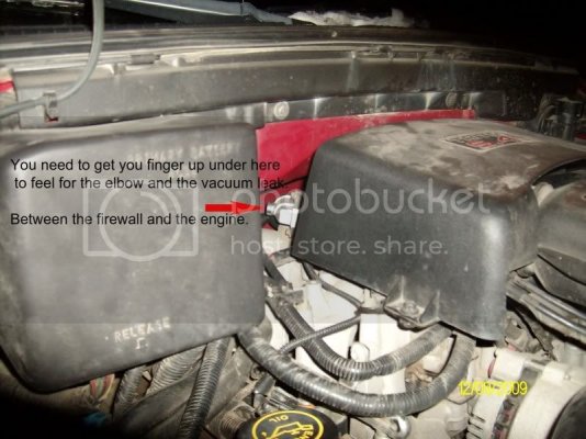

Thank you!
The picture was a big help...im a girl so looking at the motor
I was so lost...but I was able to fix it on my own. I was literally sitting in motor reading ur instructions on my android lol....thank u again! One more thing it helps if u have small hands!!!

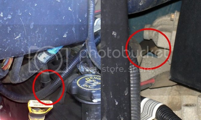

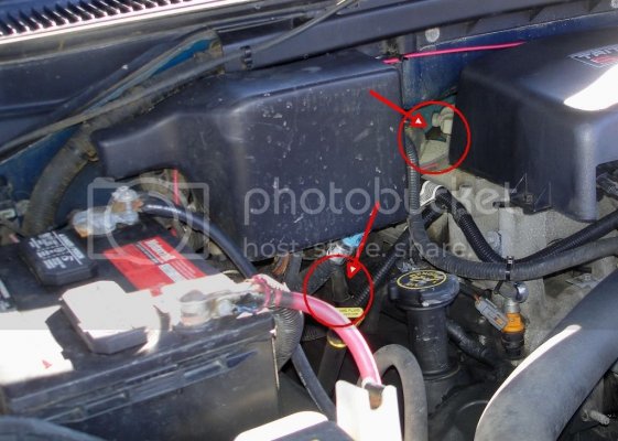

Vacuum tube assembly

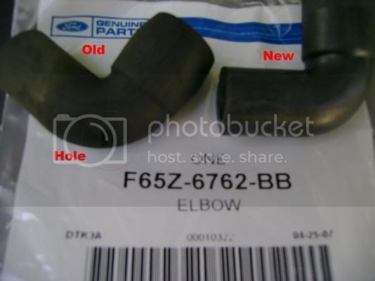

Thanks for the heads up. I originally thought it was MAF sensor bought some cleaner and that didn't work. Checked online found your post and did some further inspection. I found that the rubber elbows were both damaged. Going to call dealer tomorrow.
