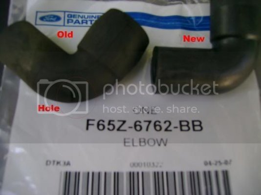

ok so i did some checking on my engine and the infamous elbow seems swollen and possibly cracked. Im going to replace it, but the hose its connected to has insulation around it, is this the heated version of the assembly? also seeing as its all plastic i had an idea, Ill make a new tube out of aluminum, steel or copper tubing, is this a good or bad idea?

fed up with all mechanics. ordered the elbow and a new pcv valve from O'Reilly auto (motor-craft brand of course), going to change them out tomorrow. I also cleaned my Mass air flow sensor today, seemed to help out a little bit but Im changing the elbow just because between all of you and the F150 forum it seems I have a 95% chance that the elbow will solve the code so wish me luck! :)
still considering if I should make a new line out of cooper tubing, waiting on your responses.

replaced the whole damn assembly from elbow to elbow, truck idles a little smoother now, gonna see how it runs the next few days. the elbow was collapsed on the inside

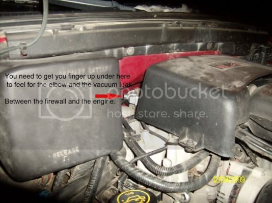

Today I tried to pull the hose that runs from the pcv valve to the intake, but I could not get it off. Is there a secret to getting it off the intake? It came off the pcv valve really easily but I could not pry it from the intake in the back near the firewall. I think I actually squished it and I noticed later when I started it back up that the elbow has extreme suction on it now when I start the truck. Is that normal?
It felt fine as far as holes and I am not sure if that is the problem. I didn't notice the idle change when I played around with the elbow back there.

Mine was kind of glued to the manifold lmao. What u need to do is using a small screwdriver push the elbow back and then while pushing back wiggle the elbow it will pop right off. Installling the new one will be easy. I also cleaned the area the elbow attaches to with MAF cleaner
