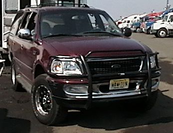

on each end of running boards theres a light that turns on when doors open.....on mine it doesnt go on............another thing,theres a DIAL,dimmer on light switch to dimm the dash lights......mine dimms but when u turn ALL THE WAY....isnt it suppose to "click"....and interior light(over head) goes on. i feel the click but no light....nothing. check fuse under hood,bulbs are good....tried a test lamp on running boards...seems like no power...with doors OPEN. this light goes ON when u open any door:cool:.
txs for help.......gonna get diagram from ALLDATA-PRO today....ill post later and advise what it says people.
97 expedition 4.6 auto...
