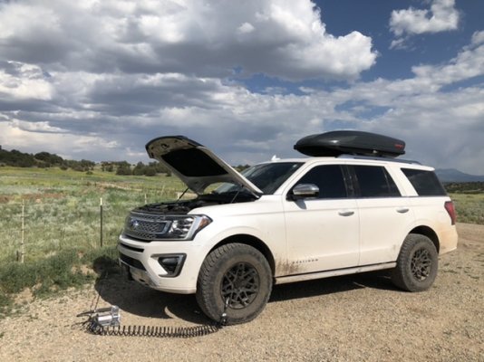

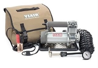

VIAIR portable compressor. Best $200 I’ve spent on my truck.
But make sure you grab it by that handle . That sucker gets HOT
