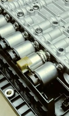

Does anyone know how to properly change a shift solenoid in a 6R75 transmission? Do I need to remove the valve body and then take off the black plastic piece?
A07A38A1-10C6-4B30-9B23-DBAA827F86BD.jpeg 00B99D54-6871-474E-9DC3-51D80D0F1A14.jpeg

My 6R75 decided to stop locking up the TC and is now throwing a wrench on the dash and a P0741 (TC clutch stuck off). My mechanic is thinking it is rebuild time.....this kind of stinks it shifts fine....
I see I can get a 6R75 out of a totaled out expy for under a grand from keystone crash parts/ LKQ with 80k miles on it......not sure I want to sink thousands into an ‘07 so that may be a better route than a rebuilt unit. They also warranty the used part if it defective. Further diagnosis will be performed later but it’s not looking favorable for this trans.

I don’t see any videos on solenoid removal for these transmissions online

I was told my vehicle will not pass NYS inspection with this code when it comes due, they cannot pass it for smog test with wrench and P0741 since it slightly reduces fuel economy....thanks NY!
I would have thought it would present more odd traits with this code when I got it read. Really the only symptom I have is the RPM’s are slightly higher at highway speeds, other than that it drives normal. Shifts smooth and solid thru all gears with no slipping or noises. I’ve never heard of a 6R75 failing with 140k on it..... Ive also been told the transmission shops won’t just replace a TC and will refuse to do anything but a complete overhaul.
OP, how did you determine you had an issue with a shift solenoid? It’s odd to me there isn’t much online for such a common trans.
