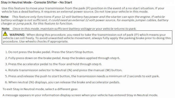

Hello all. I have a 2019 expedition. I’ve been trying to figure out how to shift the vehicle into neutral without starting the engine. In my other car, one simply holds down the push button start until the dash lights up, and then shift to neutral without starting is enabled.
The ford manual has a complex process of holding down both pedals, which allows me to switch to neutral using the selector, but it flashes and goes back to the park setting.
thanks in advance for your input.

I assume you read this process in the manual, although it is for a dead battery situation:
If your battery is functional, try pushing the start button twice (with the key fob in the vehicle) WITHOUT pushing the brake. That will start the vehicle's electrical systems and I think allow you to shift into neutral.
