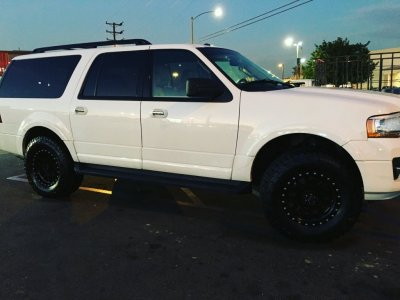

Finally got my lift and new tires installed over the weekend.
Rancho Quicklift Loaded Struts front and rear, Cooper Discoverer AT/W LT275/65R20's (34.2"), and Hypertech Max Energy Programmer.
Truck sits higher then the claimed 1.25" from Rancho on the Quicklifts. Overall, gained about 3.5" height. Looks higher in person then what I can capture in a photo.

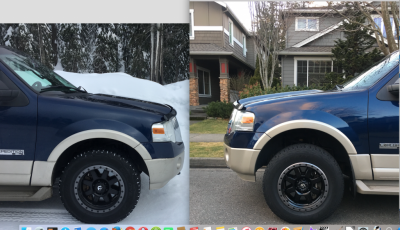

2007 XLT with Rancho QuickLift and 275/70/18 (33.2") BFG KO2's.
