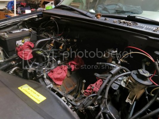

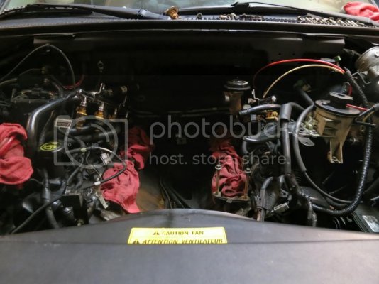

Could anyone snap a quick clear pic of their differential pressure feedback EGR connector thingy? The two hoses that run off the intake before the throttle body snake around them but I think I messed up on reattaching the bracket because it doesn't look right. The bracket with the two small hoses that fit next to each other. Truck runs kinda right but I am worried the hoses might pop off.
