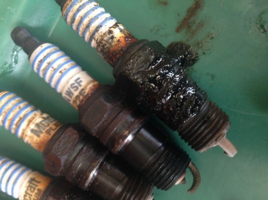

Yep. I made sure all were still there. The gasket on the electrical connector fell out of several plugs though.
Here's what my plugs looked like. Pretty sure they are factory (174k miles). Gaps were worn to about 0.068".
Think I've got a valve cover leak.....
