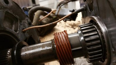

Mine was doing the exact same thing. Took the VSS (Vehicle speed sensor) out off the back end of the tranfer case and the little black gear had chips in it. I replaced the black gear and the speedometer was better but at times would bounce at hiway speeds then hit zero and the expy would lose all forward gears. Took a Deeper look and this is what I found.....
this repair can easily be done on the vehicle and parts are available. I just opted to rebuild the transfer case cause mine has alot of miles
