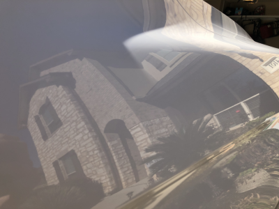

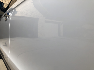

    I purchase a used 2015 Black expy. It has lots of swirles in the paint (or clearcoat). It is especially noticeable on a sunny day. Is there anyway to remove them?

    Talk to someone in the professional autobody business. Swirls are the result of bad buffing or waxing, not something that comes from the factory, unless some after-assembly touchup was done. There are professional products by major suppliers out there to remove the swirl marks. You'll have to learn to use them, but they work very well and will remove the swirls completely.

    Swirls are induced by drive through car washes, detailing the car without washing, using rough towels. A buffer and swirl remover is about the only thing that will completely take them out. I buffed out my XLR 2 years ago, and I'm just starting to get swirls back.

    That and have a shop or yourself do a color sand wet with 2500 grit sandpaper, followed by a quality compound, and a buffer with a foam or sheepskin wheel. If your using drive through car washes, stop, and start hand washing, followed by drying with soft towel. As far as wax I use a German wax in the red bottle that's super. Been using it for over 25 years. Name is Klasse.

    Color sanding is awesome but you gotta be very careful on the newer cars. The clear coat is really thin so you need to measure the clear coat depth before even thinking about a color sand.
