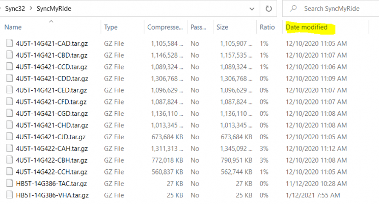

My 21 is on 3.4 21194. Nav version NA 2 20. Yesterday I went to the Ford update website https://www.ford.com/support/sync-maps-updates/ and discovered that for my VIN I have a Nav update available. I downloaded the files to my laptop and was going to install them once I got a new USB 3.1 flash drive I have on order from Amazon. However, looking at the dates of the downloaded files I have my doubts as to whether this is an actual update. Does anyone know if there is a newer version of the Nav database than 2.20?

Rob, those files look newer. I will compare when I get home later this evening.

I have 2.20 as well. Sync3Updater still reports that as the latest version. My other Ford running on 21194 received a notice to update to a prior version from Ford.

CyanLabs files have actually 3 files that are newer. The Ford download has CAH, CBH, and CCH. Cyan has CAJ, CBJ, and CCJ. Can't compare modified or created, because the CyanLabs builder tweaks that when it downloads and saves the files.
