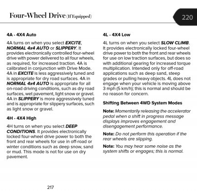

Here is a excerpt from the manual And I’ve found this to be accurate in real world use:

@JExpedition07
What is the difference of 4A and 4H? Is it still locked but % of torque is varied back to front? Anyone know what those %s are? Can it go over 50/50 to the front? I always assumed it was open in A mode to make it OK to drive on pavement/sharp turn.

The Expedition (all years) since it replaced the Bronco uses the Borg Warner Torque on Demand transfer case system. It is a transfer case with an automatic mode and uses a microprocessor located in the case and was updated in the 2nd generation trucks to be capable of predicting and reacting to slippage and also has a low range with conventional 4 high and low modes. It is capable of sending torque in increments of 10%-100% to the front in milliseconds and is almost undetectable to the driver. To answer your question yes, according to Borg Warner it can sent all torque to the front or to the back whenever needed in auto mode. Once you go into 4 High it is locked 50/50 front and rear like it would be in a conventional pickup truck and torque will not vary. This is the same in 4 low. In auto mode though it will continually vary torque output wherever needed for traction.
I am not sure about the 4th gens that don’t have 4L mode, they may use a different slightly downgraded system but from what I see the 4th gens that feature 4 low (HD tow) are the same as 3rd and 2nd gens. The cases both are casted by BorgWarner and the manuals have the same descriptions for the modes.

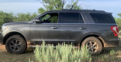

I can’t really add anything to the discussions regarding the technical aspects of the Expeditions four wheel drive system but I can attest to its real world performance. I bought a 2019 FX4 a few months ago. I took it to the ranch for the first time this past week. It took me everywhere I needed to go with no problems. We have a few narrow creek beds with muddy 10-14% grade banks. The truck had no problem going through the creeks multiple times, even in the 4H setting. Handled muddy and rocky roads as it should.
Not many people that purchase SUV’s need vehicles that can craw up steep rocky mountains. They need to include comparison test in slippery conditions such as mud or deep snow. The results could be pretty definitive, which vehicles get stuck and which ones don’t. It would also be interesting to include both two and four wheel drive models. 8B1C27A0-E735-432D-B0E6-20F4DE7B710A.jpeg690F9EEF-C917-43EA-B78F-9AC5E7532BEB.jpeg
