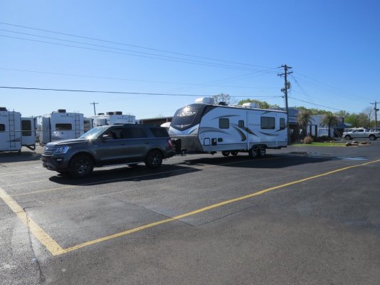

My Expedition had no trouble towing or stopping this camper. Guessing in the 7200 lb range with the front AC and 2 full 30 lb tanks. Got home and son in law re-adjusted the Equalizer hitch and I aired up the rear tires to 65 psi. Raised the rear and threw more weight to the front axle. Estimated hitch weight at 1000 lbs. Payload on my Expy is 1769 lbs. and its usually just me and the wife. Told her this is not like the 41' fifth wheel we had with a dually pulling it!!
