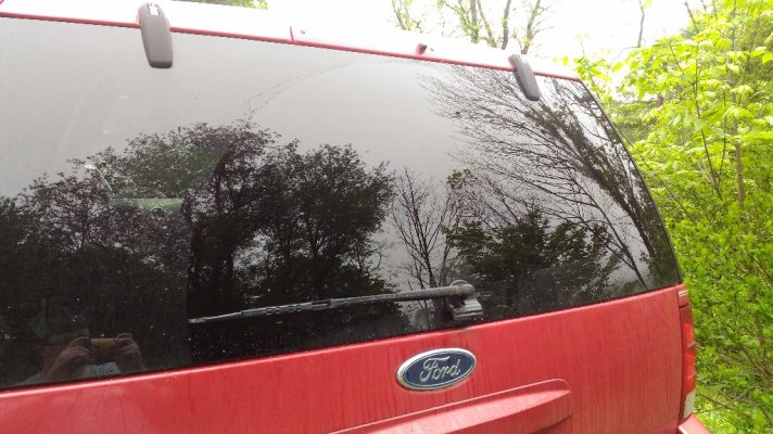

Oh, no, my wiper works fine, it's just two inches off kilter. Like, when it's off, it's not on the glass, it's resting partially on the back door too. I just gotta move it right an inch or two!

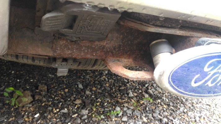

On the good side, I fixed the wiper, and here's a picture of the hitch!
