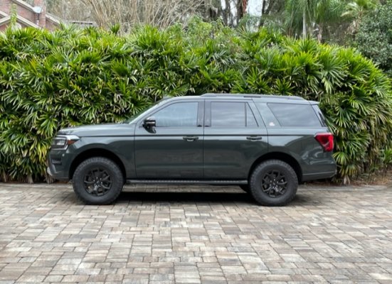

I've been wanting a mild lift for my Timberline and this looks like what I had in mind. Did you use the Ready Lift 1.5" made for the front on both the front and the back? If so, did this require any other modification? How is the ride compared to stock? Would it be possible for you to measure from the center of your hubs to the top of your fender on the front and rear. I'd greatly appreciate it.
Sorry for delayed response. 23.4 front and 23.6 rear. pretty level. Rides good. It tracks good down the road with wider tires and the height I think is just right.

I've searched off and on for lifted Timberlines over the past few months and they are very rear. This one just sticks in my head. It's gorgeous and I needed to know more. So, I called Dealer Lifts earlier today to figure out what they did for this lift. I figured I'd share my findings here for those that are also curious.
They used a ReadyLift 1.5" front leveling kit (#66-2052) and the rear 2" spacer from the ReadyLift 3" lift kit (#69-2831). Unfortunately, ReadyLift doesn't sell the 2" rear spacer separately, so you need to purchase the full 3" kit and discard the front spacer. The front spacer from that kit is way too tall for the factor leveled Timberline.
The tires on this build are 315/70r17 BFGs (which is a 34.4x12.4).

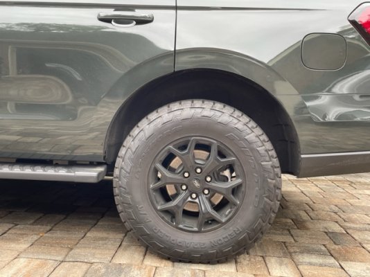

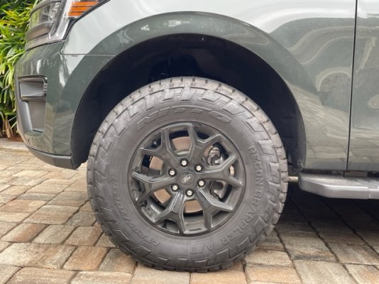

Just installed the rear 2" Readylift tonight. Happy with the outcome. Going to try to get the front 1.5" on this weekend.

Nice! My lifts should be delivered in the next day or two. How is the clearance between the rear tire and the back of the running board? I've seen mixed results on the forums when lifting the rear. I can't wait to see how yours turns out. I'll be using the stock rims and am still undecided between 295s or 285s for tire size. I'd like to keep my front weathertech mud flaps if possible.

There's plenty of room between the running board and the tire after the lift.Exp rear 2 inch.jpg
