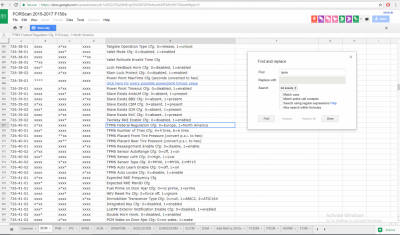

TPMS can be deactivated by using Forscan. The info for doing that is on the forum somewhere. I've never used that tool myself, so I can't offer any tips or help with it.

Andy you are correct I have seen that info now that I think about it...

Andy you are correct I have seen that info now that I think about it... now that I know that I will just have to deactivate the tpms as I'm not going to go through the headache of working on such an annoying feature anyway. Dealer wants about a grand to replace them.... HAHAHAHAHAHAAHA!!!! Is that an engineered in cash grab or what?
