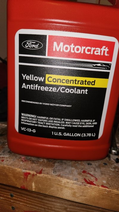

My 16' needed to be topped off after 7 yrs. I went to the Ford dealership and they gave me the Yellow antifreeze. I quickly found out that I have the orange antifreeze. After a little bit of internet forum searching I found out that the orange antifreeze is GM dexcool. I also found out the newer spec yellow Ford replaces the orange and is compatible. So basically there are two options unless you go for other aftermarket brands.

Yeah, but the important thing here is that the newer spec yellow can be used to top off existing orange antifreeze (of an older spec) without a drain and flush. Thats a different thing than your statement.

It really isn't. The yellow has replaced the orange in the product lineup (and did so years ago). If they weren't mixable, there would be no orange replacement. It was formulated, specifically, to be mixable with the orange as the factory maintenance schedule involves a drain/fill, not a flush/fill.

Except that it specifically says on the bottle not to mix with any other antifreeze. That is why I posted the Ford bulletin that says that you can mix with other colors of anti freeze even though the bottle says otherwise.
