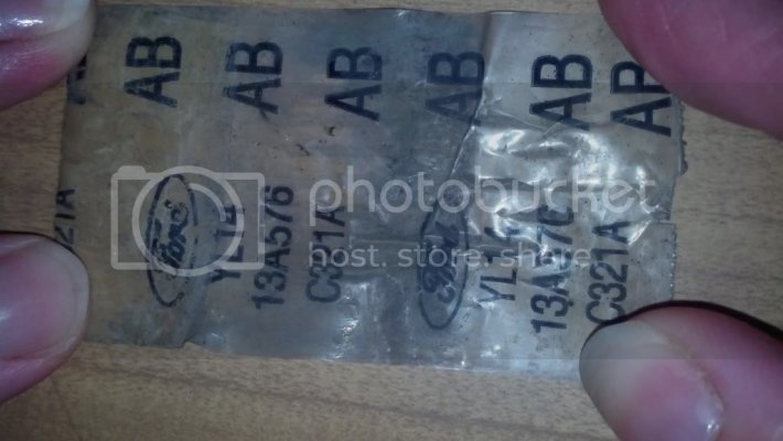

here is a picture of the connector from my expy with the HD tow package which is only 1 connector i hope it helps some

That's the connector that's on mine as well, but there is another one on the new tow harness from ford. It looks like a "T" harness. It's a round connector if that rings a bell. Thanks for your help!
