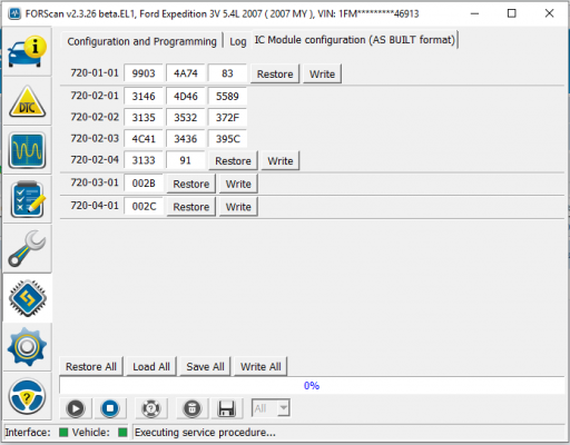

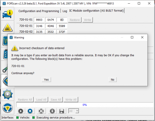

I changed the code from:
720-01-01 9903-4A74-83
to:
720-01-01 9903-0A74-83
I just changed a random number and it seems to work. I think the key is to just set it to something the ECU/Instrument Cluster doesn't recognize and the error will dissapear.
I can't thank you guys and this forum enough. Today is a great day.04b4975a5b96bc9c2864f79071e317be.pngb2ea97519ea1308bdc1419bc39146873.pnga89b5e94f83263b6f96b4fdd808a5788.png
