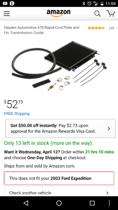

And this is the cooler that I'm looking at as it got alot of good reviews
Will I need to order any special connection for this cooler ?bcc4ee9b9d896ca99582b977032f5567.pngd87f9a1b320a833c9fcd0041b330d7c7.png
