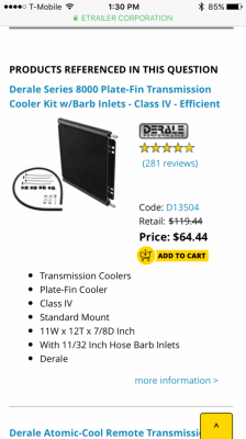

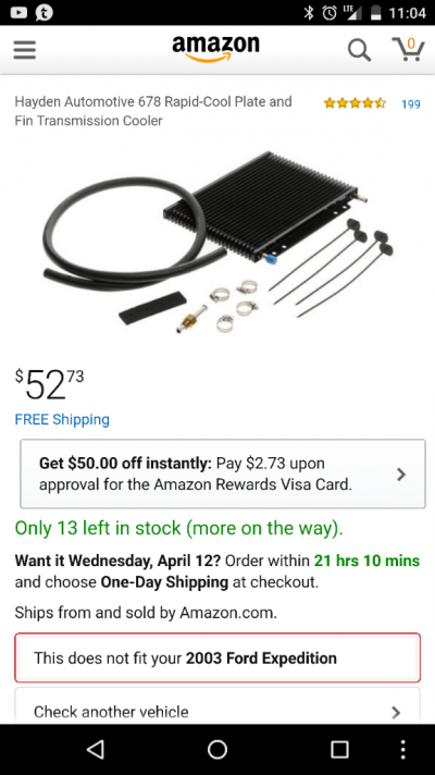

Cooler is way better than not cool enough.
A popular swap for people with 4r100 transmission is to run the same cooler that the 6.0L Excursion came with. That's my plan.

Yeah. Although I'm not sure on the hose barb size. Since you'll be putting rubber lines on (either the ones supplied or your own) you'll need to make sure it'll fit.
