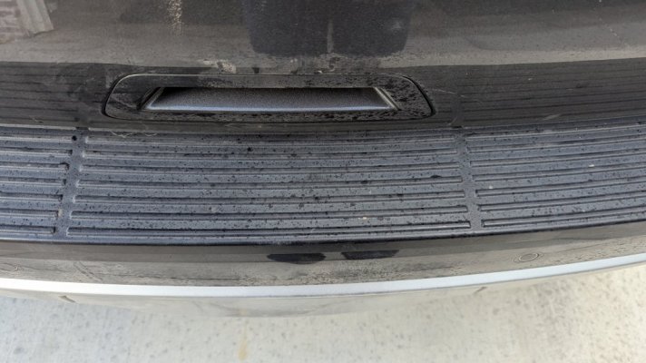

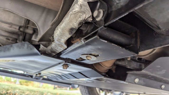

Dag-nab-it. Wish I wasn't posting this right now but I am. Mine was in the shop for 5 and 1/2 weeks for a valve body replacement. And all seemed well for about 2 or 3 weeks. I just recently went on a 800 mile round trip trip with my family, and everything seemed to go well except for the trip home.
On the second to last mountain pass, I went to pass a tractor trailer and I manually shifted from 9th to 8th gear. The entire vehicle lurched, as if accidentally shifting from 3rd to first in a stick. Scared the kids awake! But this happened twice in about 20 seconds. Within 5 minutes, the tranny temp went from normal to about 243 degrees. The highest is been since I've owned this car, and I've driven this exact pass probably 15 times.
I didn't get any dtcs or check engine lights, but I backed off everything at the point in time. I took the pass a little bit more leisurely than usual, and on the way down the temperature of the transmission dropped back to about 205°. The ambient temperature outside was around 60° f. Everything seemed okay for the entire rest of the trip home, but as soon as I got home and started unloading the car, I knew there was something very bad.
My rear bumper and even my rear wiper were covered in what looked like WD-40. I instantly knew something wasn't right. Crawled under the vehicle and found that the entire undercarriage, my skid plates, cross members and even the rear axle are covered in fluid. I can see transmission fluid dripping from the bellhousing.
It's interesting to me that there were no check engine lights, or even dtcs, but something drastically went wrong with the transmission.
I'm trying to get an appointment for tomorrow or this Friday, but I'm a little upset that yet again after just a few weeks of getting a major transmission service, the transmission is actually doing worse than it was before. Does anybody have any ideas of what might have happened?
To me, this is a classic case of the transmission blowing. The temperature Rose incredibly fast, it wasn't like something that happened gradually over time. I also don't understand how there's so much fluid all over the entire undercarriage as well as the rear window and windshield... Could this be that's a transmission was overfilled? Or is this more symptomatic but bigger issue? At this point I'm almost demanding a new transmission. What would you guys do?

I would be leaning more toward something done incorrectly by the tech that did the recent work, either overfilled, left the fill plug loose or did not reassemble correctly.
The fluid all over the rear of the vehicle is the easy explanation. As air moving over and under the truck comes back together at the rear it creates a low pressure area sucking the air that is exiting under the truck up - same thing that creates lift in airplanes - Bernoulli's principal of flight.
I get how the air flows, and thus the oil got there, my issue was just the sheer volume of oil everywhere, and how small the droplets are in many places, tells me it was definitely under pressure when it blew. I was very nervous about this trip after the tranny work, so I watched the temps pretty diligently. Just before this pass, I was on a pretty flat stretch of about 30 miles, almost all at highway speeds so the tranny wasn't doing a ton of work, the temp increase happened so suddenly.
