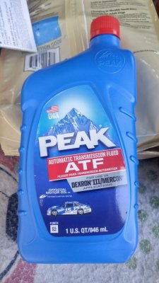

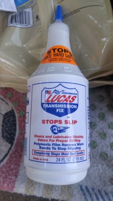

Think I've got the trans issue figured out... They hold 15 ish quarts, i was really really low. Added a quart of Lucas transmission fix and almost 6 quarts of fluid and it's now actually registering on the stick when checked at hot idle. There is a little leak. Parked in a different place to see if any puddles developed and there was a small one. The Lucas should fix that. I'll be cleaning the driveway and parking there again to see if the leak persists. See pix for the ATF and Lucas I'm using.

The manual says mercon atf. The carton of ATF says suitable for use in Ford and GM vehicles where a dexronIII/mercon ATF is recommended, but then the dipstick days mercon v on it what's the difference? This is what I was told to get
