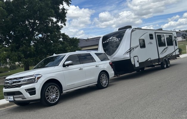

I'm looking to upgrade my current Lance 1985 TT (23'8") with a longer 28'10" TT. The Lance had a GVWR of 6000# and the new TT has a GVWR of 7000# but is 5 feet longer. Any concerns pulling a 29' trailer with a non-Max Expo?
I pull a 34. It pulls it fine. No question bigger is better. On a recent trip we drove about 400 miles with 20 mph constant side winds with gusts well above that. It obviously moved around a little, but never enough to concern me. I do have a good weight distributing hitch on it.
This picture was take when we got home from the dealer. I have set the hitch up better to level it out more.
That is one good looking set up!
