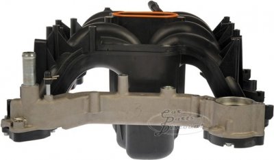

Found photo online. Since it is pressed in you may have to do as stamp suggested unless you can find what it goes too and reconnect. Interestingly enough that nipple is not shown on the exploded views in my ford shop manual ?!. Possibly a replacement manifold that has applications in different vehicle??
Doesn't exist on mine?!
