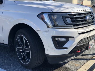

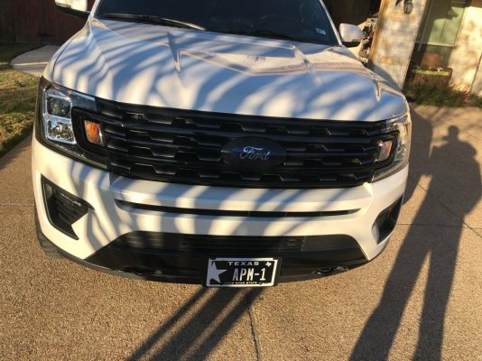

Got to work on blacking out all the chrome trim.
Maybe I missed it somewhere along the way, but how did you go about blacking out the chrome? Plastidip? Wrap? Paint? Just curious, as I like the look and am contemplating doing it as well...
WJD_xlt
Jul 15, 2019
88
60
socal
I did plasticdip. Out of habit, I use a pressure washer and foam cannon when I wash my cars, and I blew off all the plasticdip LOL
So I’m going to do it again, but use SEM black trim paint.

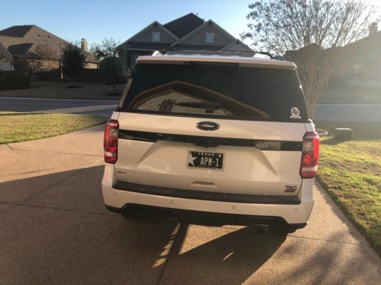

Need help with what I have done. First post. Added S&B CAI and 5star tune to my new '19 Expedition platinum. Had CEL after CAI and was told by 5star that it should resolve after loading tune- -but it didn't. Now I also have P0022 (camshaft position over-retarded) in addition to P0113(IA Temp Sensor circuit high). Truck runs ok. Has anyone had this problem and or know how to resolve? 5star recommends replacing with stock air box. Appreciate input. Here is a pic of my Expedition/Supra.
