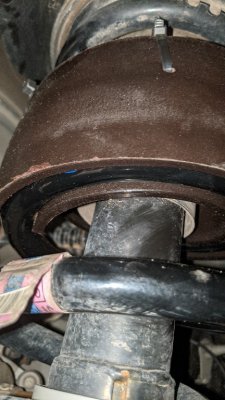

My second project was the Sumo Springs. While I don't intend on towing 10k lbs very often, I wanted to stiff up the rear a tad, and it definitely worked. The sumo's combined with the front and rear sway bars feel amazing. Cruzing around some tight entrance ramps while accelerating, this things feels better than it should honestly. These were a bit hard to install than I was expected, even with the suspension fully extended. If you go to do this, definitely make sure you lube the springs with a little soapy water. Even though I'm sure I might not need to, I didn't secure mine with zip ties.
