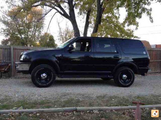

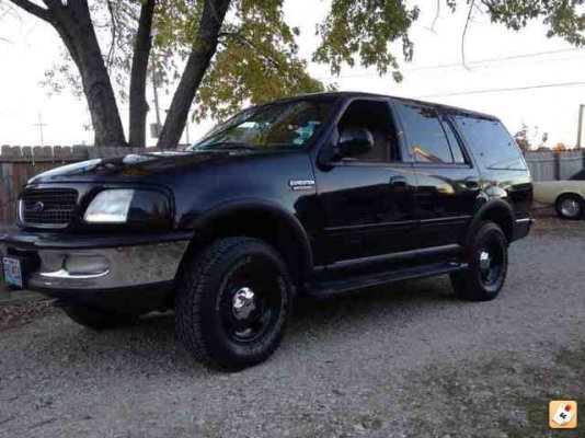

So this weekend I decided to paint the wheels but have been trying to decide whether to go with Plastidip or wheel paint. I decided to go with VHT's black satin wheel paint with their clear coat for a bit more glossiness and extra protection. I've used this brand paint before on the engine compartment on my Mustang and have been very happy with it. It sprays nice and dries to the touch in about 20 minutes. So here's some pics of what I've done. I also used bedliner spray for the trim. I'm thinking I'm going to get the Duplicolor shadow to spray on the bumpers. enude3a8.jpguheja7yd.jpgmuvapyna.jpg

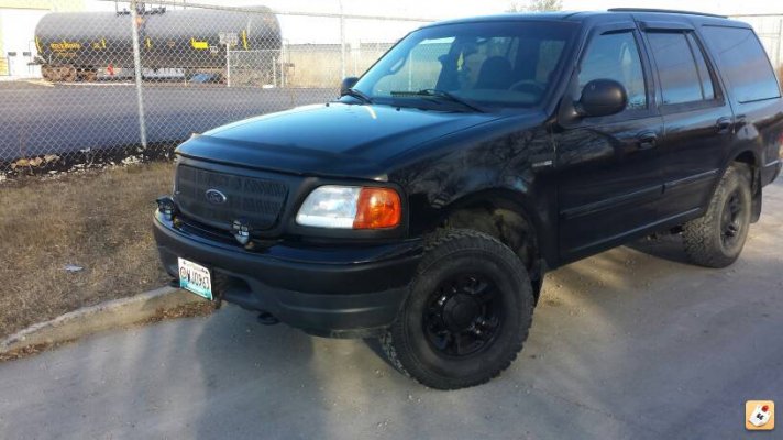

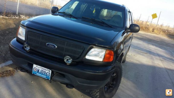

Wow or trucks look (Ed) very similar! Nice job! I used plasti dip on the bumpers it's holding up so far during the beginning of winter, I guess what they look like in the spring will be the answer to whether or not it's very durable. I didn't want to spray paint on the chrome bumpers because I've found our doesn't hold will unless you go all or on etching etc.

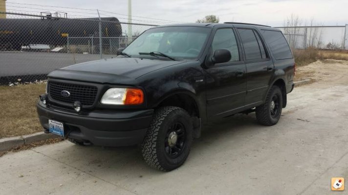

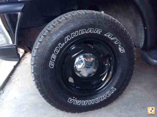

I used plasti dip on the front and rear bumpers, I would have used it for everything but I only had one can, it's not available here where I live some ppl sell it in the local classifieds I guess they order it from the us. I used a rust paint called"rust check" idk if it's available everywhere or just here because rust is such an issue on vehicles, but it's incredibly tough and I had it laying around so I just used it, so the wheels are gloss black rust check paint and the caps are flat black rustoleum.

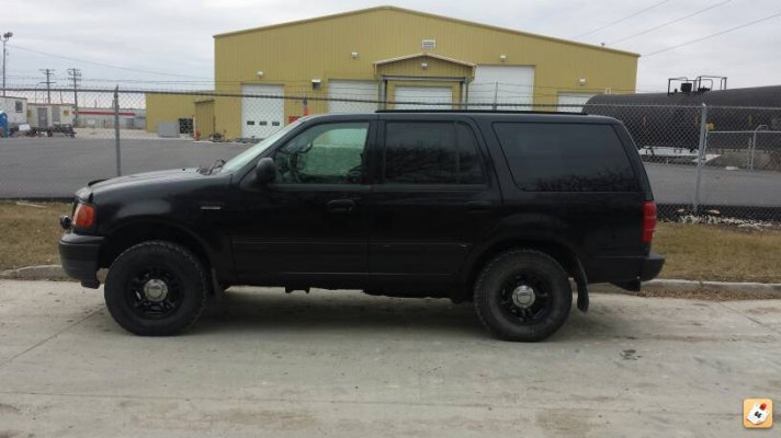

2001 xlt. 331,000 kms im the 3rd owner and this vehicle was well looked after, I'm still shocked that I got it for 1600$ and that it runs so well with that many kms. I just checked and that's roughly 205,000 miles

I just pressure washed the wheel's really good and then took them off the truck and cleaned them again and I just started putting on really light coats, spraying the harder to hit areas first, I lost count of the number of coats I p ut on but I just kept putting on light coats with 20 min breaks between coats till the can was gone. The tcoverage that the rust paint gave me was insane. I don't think I ever painted a set of wheels with just one can but that's all I needed. Usually if I use vht wheel paint I go through 2 cans minimum this is the first time I did it in one.
