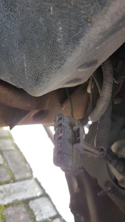

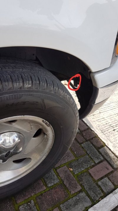

Where does this harness go? inside right front wheel well. (image)

just saw it sorta dangling inside the right front wheel well.
all my lights up front works.

Not to hijack the post, but I also have a harness dangling, but at the driver wheel well. Could be the same thing... any help would be much appreciated

It looks like the pigtail that goes to the air ride suspension relay that is normally mounted in that area. Probably on all the wiring harnesses even if you do not have the air ride suspension and thus no relay, in which case you can disregard it.

I've discovered I have an identical cable loose on the passenger side as well. I was thinking they could have attached to the lighted bumper valences, as my expy doesn't have them. I didn't know the eddie bauer's had air suspension at all 4 wheels, thought it was just the rear.

I believe for the rear air suspensions, the relay is mounted on passenger side front wheelwell area just below the air compressor. Don't know about the drivers side.
