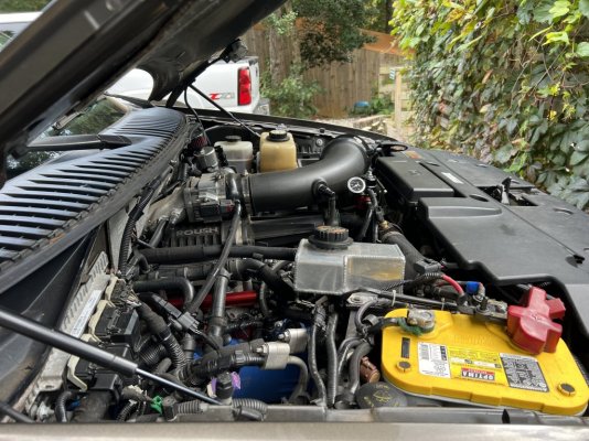

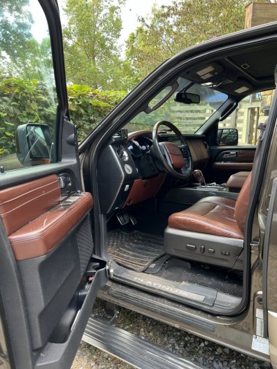

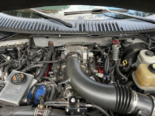

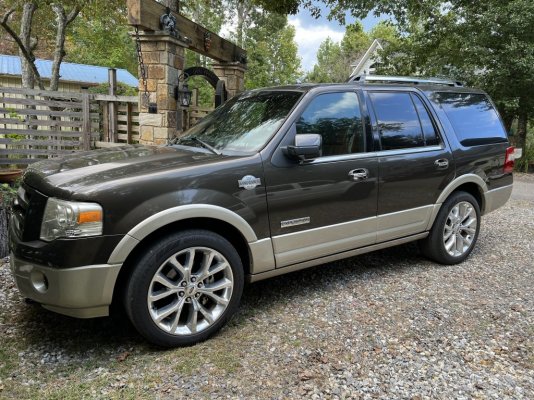

My truck is a 2008 king ranch 2wd 3v stock engine, cams, and 2014 6r80. It has a custom fuel system gt500 pump assembly custom built, runs on 93 & e85 I’d1000 and 13 psi of boost on a roush IC set up. I’m in the 12s but haven’t really gone crazy with the truck it’s my daily and haven’t had to open up the engine yet since I bought it back in 2013. Has full kooks long tubes & green cats emissions intact. The custom return fuel system with areomotive rails and regulator vacuum ref, a 5.0 tivct pcm 6r80 sect shift eps, drive modes all one of a kind do all my own tuning and building truck has been boosted for 5 years now with no issues. It’s a great truck and I love how guys hate the 3v cause they buy ones that were not taken care of for cheep and complain. I will tell you this I have a 2016 navigator reserve and it’s definitely fast but my expedition walks all over it. These trucks are heavy they can only do so much when the laws of physics apply lol.
