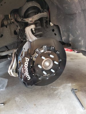

Here are some pics of my test fitting of the Wilwood BBK...

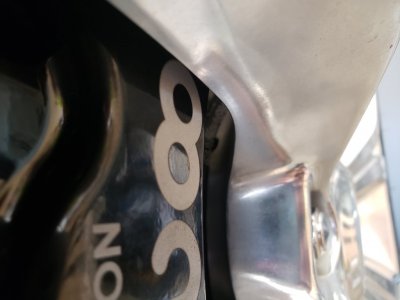

The stack of washer represents the clearance I have from caliper to rim...
I am debating if this is too close for comfort before I hook up brake lines. Think that's enough clearance to be safe?

Seems like quite a bit of clearance. Calipers do move slightly when applying the brakes but the movement tends to be towards the rim vs the spokes. I had a stick on wheel weight once on the inside of the rim that would only rub the caliper when applying the brakes but not under normal driving. Maybe spin the wheel while on a jack stand and stab the brakes while an assistant watches to see if there is any movement of the caliper.

That's lots of space between the caliper and the spokes. You also have at least 2 inches of clearance between the caliper and the rim, so shouldn't be any issues. I checked my stock caliper and it's 1/2" away from the spokes at the closest spot, so 3/8" should be fine.

Well ****... Everything lines up and the 22inch rim seems to have enough clearance but the brake lines provided could not be installed. Threads appear to be the same and I insured it was perfectly parallel when started to thread and no dice. Old lines went back on fine. Need to find a substitute adapter before moving on. :(:uhoh2::thumbsdown::thumbsdown:
