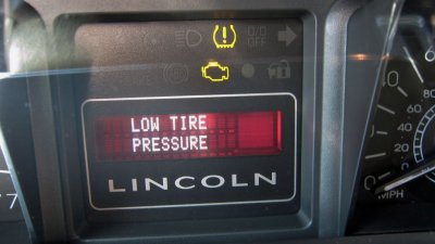

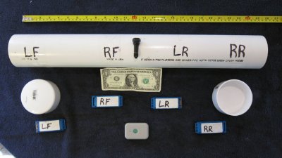

I don't like the orange light and the text always on the dash so I am in the middle of putting some old tpms's I got online in a tube and pressurizing it. The little tpms computer learning tool changed the text from "tpms tire fault pressure"? to "low pressure" and I plan to attach this tube underneath with the 4 Ford 315 MHz sensors in it. I will give an update.

I thought I understood that centrifugal force (ie: the wheel spinning over a certain RPM) was needed to "wake-up" the TPM sensors. Seemed logical as this style of system would extend transmitter battery life.

Maybe on some later models and some go by rpm's of the wheel.

I just wanted to experiment with these used ones first. I wasn't aware of sensors until I bought this a month ago and don't want to break it all down etc. Also most Expys in here are probably worth more than I paid for the '07 Navi.

Yes you can do that but I didn't want to.
The later ones read each tire pressure and tells you what it is, they evolved but mine makes you look for the low one but I don't need any of it. When the batteries go dead in them everyone is going to have to stop and replace them and the dealer wants a ton of money to do that. It's not just the sensors, it's programing the new ones to the vehicle (if you got the right ones), and breaking all the tires down before they are worn out or look at the light and text on your cluster constantly bugging you to correct it.
