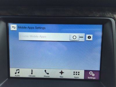

Yes my screen looks similar to that, I have some different apps.
I get messages but I have never tried the maps because I have Navigation. (I was really hoping that Waze would work because we put that on the iPad and use that for navigation because of knowing where the trouble spots are, and where the cops are sitting.)

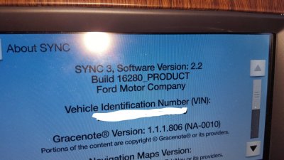

Ford is not updating any 16's from 1.0/1.1 to 2.0/2.2 that I am aware of at this time. Not sure what they are waiting for. Lots of talk on the F-150 and Edge Forums about it. A guy named Jason has access to the updates and has shared installs that will do the update. 2.2 is technically the highest, and what the newest Fords coming from the factory have installed. Anything 2.0 and above supports AA and CarPlay. CarPlay requires a USB hub with a certain Apple certified Hub. Most 16's, at least Mustangs, and Edge's that I am aware of for sure need to swap the Hub to get CarPlay. It makes sense that the 16 Expedition would be the same.
I have the install files to take any 1.0/1.1/2.0 to 2.2 if anybody needs it. I worked with Jason on testing the install. I have done several friends with no issue.

No updates OTA for Ford vehicles that I have heard. Some Lincoln owners have reported OTA, but no fords that I have heard about. Delivery system is there, but ford is holding back. If you have a 17, you have 2.0 or above, and a compatible Hub.

Yep, Exactly what I said. Sync Chat Honestly knows less than many of us about their own product. I have done more Updates and more research than the 3 dealers I have talked to about it. 2.2 WILL install on your vehicle, as it is installed on my Wife's 17 Limited EL, and 2 friends Expeditions. You just need a flash drive 2GB or more, and a download link. With that said, going from 2.0 to 2.2, only gains You small tweaks in the interface and nothing significant.

2016 Edges did not have a hub that had the Apple certified chip in them. I swapped my hub for a supported one. My guess would be that the 16 Expy is the same way. If you are at 2.0, you have the software level you need. Verify you see Android Auto in the Settings menu. Do you see a CarPlay icon beside it, if not, your hub doesn't support it, and will need to be swapped.
