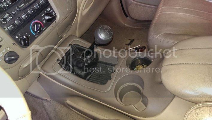

Quick pic of my final decision on the interior.
A little redneck ingenuity and some help from my GF and the manual trans looks stock!
The only semi tricky part was fabricating a "V" shaped bracket to adjust the shift lever angle. No, I didn't get any pics of that process. Was in the groove and makin' progress. Besides, it's like a movie I and can't give away the plot twist in the end. :emotions33:
