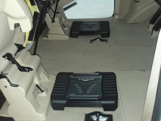

BTW, which Kicker Amp did you get and where did you put it? I am using two Kicker ZX200.4 Amps as part of my speaker upgrade.

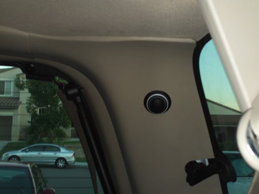

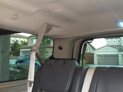

Well I just finished wiring up my D-pillar speakers to see how they would sound and I am very impressed and even surprised. They are 1" tweeters from the Infinity Reference line and they definitely add some nice rear fill, and I have an EL too :) . However, I am sure any decent brand 1" tweeters would perform just as well.
I still plan to flush mount them to my original D-pillar trim pieces. But if I don't like how they look, I still may get the factory D-pillar pieces (w/o the speakers) and install them in there.
My install is not completely done yet (I need to put the car back together now :eek: ), but I would definitely recommend this upgrade to the sound system, whether you use all OEM parts or aftermarket.

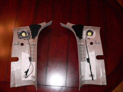

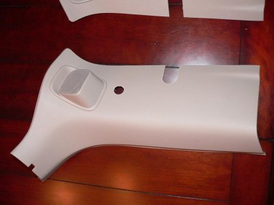

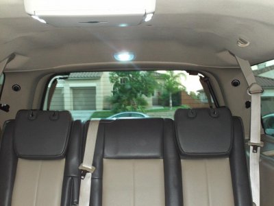

Here are some pictures of my installed speakers in the 3rd row...first two are Right Rear D pillar and third one is Left Rear (sorry about funny picture angle). You can see that the factory panels place the speaker at the optimum height and angle to maximize the sound for the passengers in the third row. Even the 2nd row passengers can hear the speakers as it blends the overall sound nicely. You can hear it very faintly from the front row, if at all, went the fader is centered for all sets of speakers.
I think it really helps out the third row to balance out the sound output of the subwfr for when someone is sitting in that third row...all that base can start to drive you nuts...not so anymore.
Cleanest install i've seen in a while! Enjoy it.
