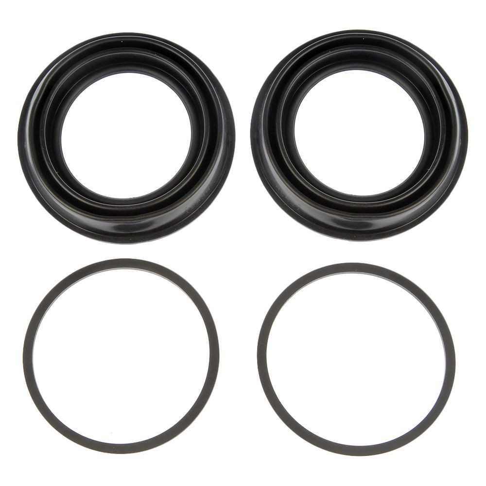

There is not much to removing the calipers. Use the C clamp as you normally would. Motorcraft discontinued new calipers, so you are stuck with aftermarket. When my calipers go out, I will rebuild them myself. It is just seal replacement and you will probably do a better job than the reman places. Below is one of several rebuild kits available. I also recommend replacing the springs and hardware using Motorcraft part BRPK5756.

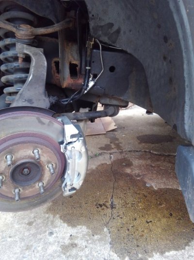

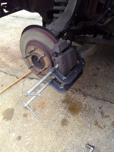

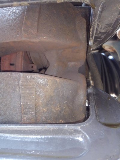

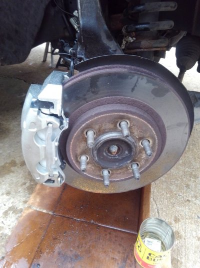

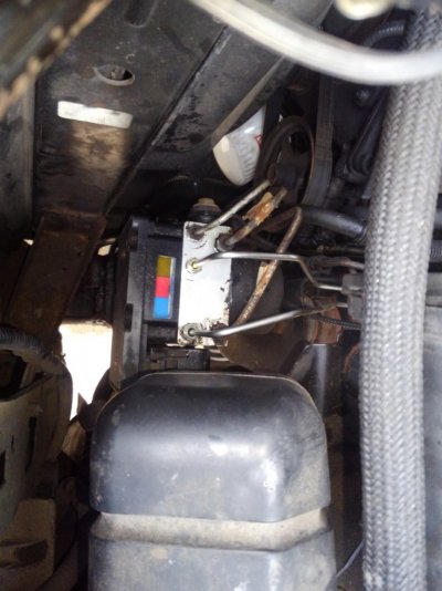

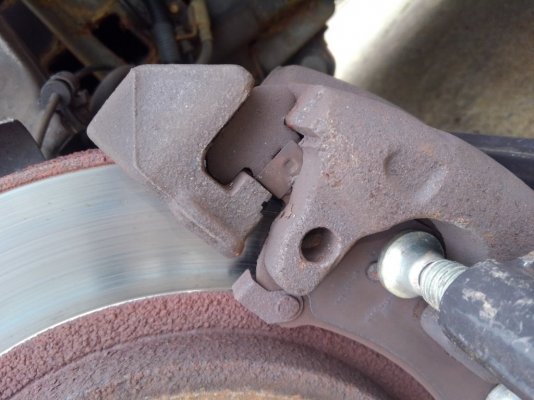

Ok, what I found out now. First brake was dragging. Second the guide pins had no end caps and the bottom pin was partially stripped, ended up hammering a torx 47 size and carefully worked it loose. Third the outside spring was there but no inside spring. Pads still have some meat on them but no wear guides on the main brake mount (small guides on pads can be seen). The weird thing was starting to back off the calipers it would not move and I did not want to over do it. Next tried the bleeder valve screw backed off. Fluid came out and the caliper moved. re-tighten the bleeder and tried again to compress the caliper. It moved with some effort, not as easy with the bleeder open.
Is it possible that the anti-lock brake box is holding the fluid back??? The easy answer is the brake parts are screwed and a cheap pad job was done to limp the truck along. But how to check the anti-lock block short of slamming the brakes in the driveway or in front of the house to see if things lock up again??? It looks like a caliper set (matching), pads (I like semi metal) (won't trust the existing ones) - Pins - guides - springs - "banjo bolt" for brake line connection and type 3 brake fluid. Any recommendations on sturdy lubricant (on cars I use anti-seize). I plan on using this for towing (moving to another house) so brakes are kind of super important now.

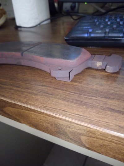

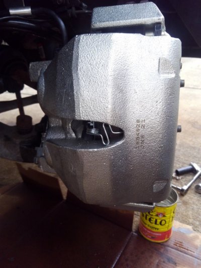

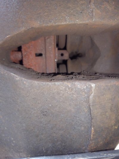

Update, got the caliper off. No other complications, turning the c-clamps were still a little hard. It felt like something was slowing down the fluid flow. Could be I'm just not used to this yet. Wheel without caliper turned around smoothly and it still is connected to the differential (shaft to transfer case is spinning). Still has meat on the pads, the inner one is the same amount of meat as well (picture).

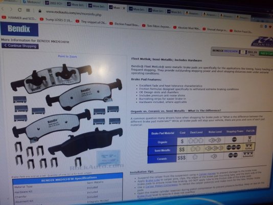

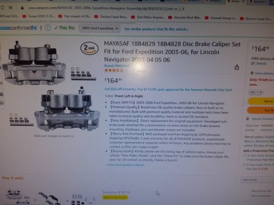

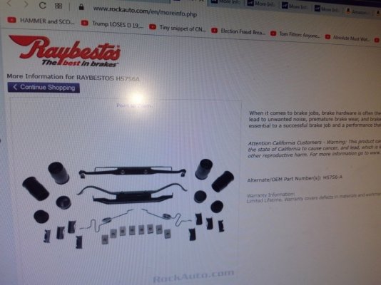

Since the caliper put up a fight at the beginning I'm forced to throw out the idea this is just a return spring missing problem. Good brake fluid was used when I had the brake line re-placed to the rear. I did not bleed the front brakes (don't fix what ain't broke kind of thing). I'm possibly paying for that now although missing wear guides and inner return spring(s?) does help that line of thought. Any way I'm shopping for the best combination of parts. Screen shots of what I found so far. Any good or bad thoughts ???

@Lee_H thanks for the update, this is interesting. I don't have experience with the parts you were looking at. I always use Motorcraft unless discontinued, even if it costs more, just because I will keep my Exp forever and I usually get burned with aftermarket stuff. I did install a Raybestos master cyl last month (Motorcraft discontinued) and it has been fine. That forced me to do a full brake fluid flush. Brakes work and feel much better. Night and day.
You might want to closely inspect the caliper and seals. It probably got red hot multiple times so it might need some love. Let us know how it works out from here.
