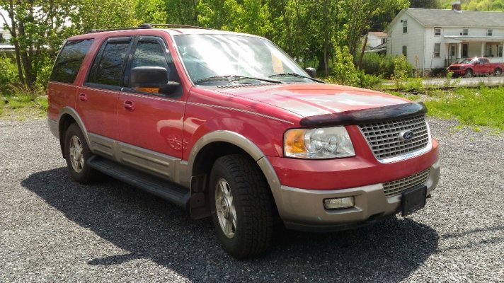

So, I wanna get something new. There's a 2003 Eddie bauer explorer for $6450.00 right now near me. It's currently $600 off as a promotion! And if I turn in my loud trash heap, I can get another $600 off. I currently have $2000 saved up, and my family was going to loan me the rest (I'm 20 and I'm talking to what I hope becomes my second job, so I plan to pay that all back)

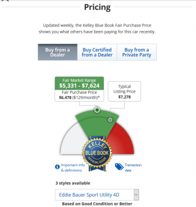

Take a look a Kelly Blue Book for the value of the Expy. It's worth between 3-4k in good condition. The dealer is taking you for a ride. Honestly if you can't get that thing for under $4k I'd walk away from it. He's not giving you ANYTHING for your Explorer. He's building that little incentive into the cost of the Expedition you want. Expedition seats won't hold up very long for anyone over 250 lbs. and it's an extreme safety hazard when that seat back collapses and you're rolling down the highway. 70 mph and you're staring up at the ceiling wondering what happened. The seats are just not made very heavy duty. Really you should be looking at an F250. They have much stronger seats in them.
