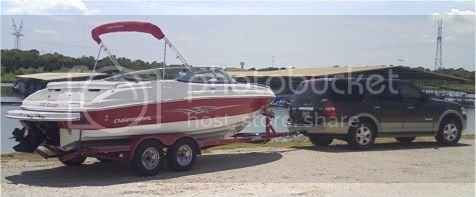

Here's my set up that I have never had a problem with. Factory hitch, solid receiver, 10,000lb ball(overkill) and no WD bars. My trailer is pushing 6000lbs and stays glued behind my Expy. Surge brakes on the trailer.
