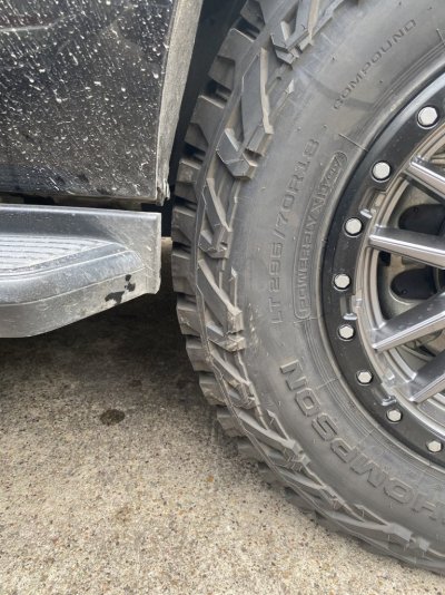

Looks awesome. Any issues with running? And What size tires/wheels?
Wheels; 18x9 +20mm
Tires: 295/70R18 (34.3" diameter)
I had to tuck the front felt material forward just a bit to avoid rubbing. Otherwise there are some spots that are really close but don’t rub. I can’t imagine how a bigger tire would fit without quite a bit of work.
Look at how close the front tires are when turned in this picture.

I’m running the exact same size. I tucked the felt wheel well liners at all four corners just to be sure.
Also had to trim the power running boards—about an inch off the front. Basically you are removing the section of running board that extends into the wheel well when the running board is stowed in the “up” position.
