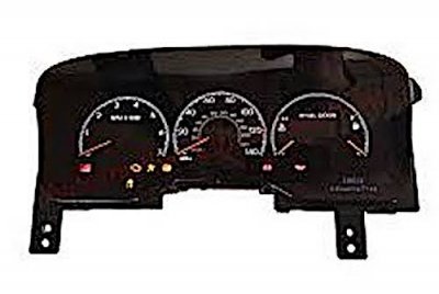

I hopefully can explain what the cluster is/isn't doing well, so here goes! The cluster is dark, not lit in anyway, you can't see the gauges to know if they are operating. When you shine a bright light, when the vehicle is running, neither the tach, or temp gauge function, the odometer is not illuminated, nor is the driver information center located on the right side of the cluster. What will illuminate inside the cluster area is the airbag light, that is staying constant. The turn signal/flasher indicators light up, as well as the high beam indicator. At one time when you first has me run a wire from CJB to ignition to get it to start, I did notice the door ajar and shift indicator were illuminated, at this time they are not for whatever reason.

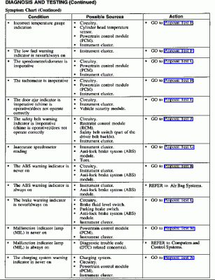

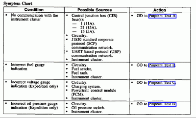

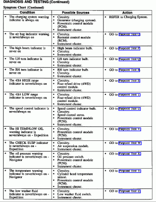

Here is what I have, plus I found some pinpoint tests that I hadn't seen before!
  • InstClsWrngOverview.pdf
  • NaviInsClsWiring2.pdf
  • NaviInstClsWrng3.pdf
  • NaviInsClsWiring4.pdf

Here are the PinPoint Test!
Fuse #1 - power with Key ON only (not sure if it should be on at all times)
Fuse #21 - power at all times
Fuse #15 - power at all times

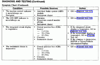

PinPoint Test's: A and AD
  • InstPinPointA.pdf
  • InstPinPointA1.pdf
  • InstPinPointAD1.pdf
  • InstPinPointAD.pdf
