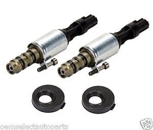

If you do phasers, and if those VCT solenoids are the original ones, get new ones. They have gone through a few revisions, and the latest version reduced the famous 3v phaser knock and all. My original ones looked fine, not gunked up or anything, but I noticed improvements on the mileage and it seems like the engine is more responsive with the new ones, making me believe the older ones perhaps was worn internally and didn't seal well enough when closed.

Skauber
May 31, 2014
366
29
Cagayan de Oro, Philippines
Yes, I was planning to replace my phasers. It had a pronounced knock, almost as loud as a modern 4 cylinder diesel. I replaced the VCT solenoids as a "last resort" before diving in to the phasers, but the noise went almost completely away after replacing them. If I listen carefully for it, I can still hear the knock but it's very faint and I suspect that even brand new phasers have a small amount of knock in them so I won't be replacing mine just yet. I am also running 5W-30 oil in it due to the hot climate here to help it along a little. 5W-20 is very thin around here.

Interesting. Did you go for genuine Ford parts or go aftermarket?
I have tried 5W-30 as well. It didnt seem to help much. But swithing to Valvoline's High Mileage 5W-20 did help overall. The whole engine seems to run quieter and smoother.

I got the latest revision of genuine Ford solenoids. For something like this, I'd never use an aftermarket part.

I got mine on ebay for about 130 bucks shipped internationally, including the seals, so it's not too expensive.
2005 2014 Ford Lincoln 5 4L 2 Variable Camshaft Timing Solenoids Seals | eBay
You'll need a T27 torx to get it out, and I strongly recommend getting a 1-piece tool. I know some tape their bit on and what not, but it would really ruin your day if you dropped that bit inside the engine.
